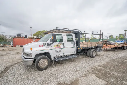

Inspection Summary
inspector
Inspected by Boom & Bucket
  • 1200+ inspections
  • 50+ years experience
  • 20+ certifications
What's great
  • Good engine performance; easy start, smooth idle, no unusual noises heard
  • Clean & dry engine compartment, no leaks or seepages seen
  • Body panels & frame in good condition, no signs of damage or weld repairs
  • Cabin controls, displays & gauges are all complete and functioning
What needs work
  • Battery service indicator is illuminated
  • Cab shows heavy cosmetic wear: stained & torn seats, loose headliner, worn surfaces
  • Front left chrome wheel cover is damaged
  • Steel Backboard & Backboard Toolbox
  • Side Tool Boxes
  • Tow Hitch
  • Wood Stake Side with Latches + Rear Gate Latches
  • Engine Oil Cooler
  • Rack Top Mounted Strap Reels
  • Cab Steps
  • Running Lights
  • Chrome Wheels
  • Engine: Duramax Isuzu 6.6L 300Hp V8 Diesel
  • Automatic Transmission + Over Drive
  • 2WD
  • GVWR: 17,500 lbs
  • Hydraulic Brakes
  • Wheelbase: 169 in
  • Tires: Hankook 225/70 R19.5
  • Stationary Hydraulics
  • Front Axle = 7,000 lbs / Rear Axle = 13,500 lbs
