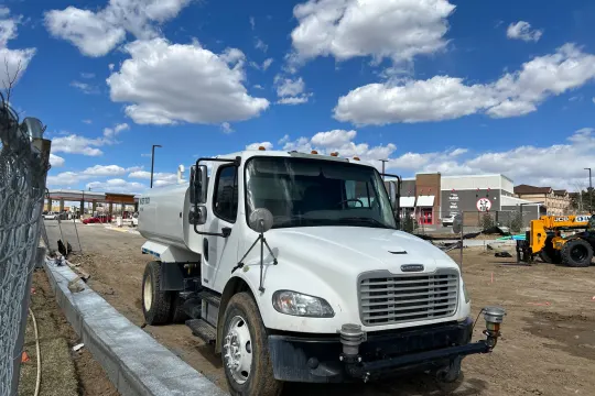

This 2007 FREIGHTLINER M2 started out as a flatbed with a lift-gate. This truck has a new 3126 Caterpillar Tier 3 engine. The engine does not have the Tier 4 emissions and is currently seeing high demand by many truck owners. The current seller bought the truck and had the flatbed taken off and had it updated to a water truck in 2011 or 2012. The water truck has a 2000 gallon water tank with a total of (5) nozzles. (2) front nozzles, (2) rear nozzles, (1) drivers side spray nozzle that turns in between cab and water tank when not in use, and one hookup point for a hose on passenger side of truck. The truck has a short wheelbase and is a good fit for small construction sites that have small or tight areas needing water.
