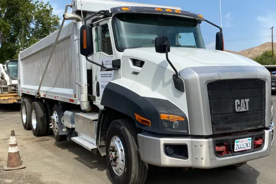

What's great
  • Clean and dry appearance engine appearance
  • Good forward and reverse function; no unusual transmission noises or vibrations observed
  • Good brake function; no front or rear differential noises heard
  • Front tires are at 90% tread remaining; left rear tire is at 70% tread remaining
  • Brake shoe thickness is at 70%
  • Clean hydraulics, lift and drop functions perform well
  • Good appearance of body panels; no damage seen
  • Good cab appearance; good function of controls and switches
What needs work
  • Two oil seepages seen on the left side of the engine
  • Engine oil needs to be changed
  • Left side tarp retracting mount needs to be repaired or replaced
With low mileage and an extra long aluminum dump body in great condition, this truck is ready to be driven for full work shifts. As a CAT truck, the parts and services available for maintaining this beautiful machine are second to none. Contact our sales team for more details!
