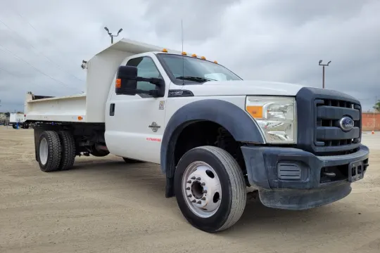

What's great
  • Clean and dry engine compartment, no active leaks
  • Engine starts up with no unusual noises or smoke issues
  • Transmission components are in good condition; no unusual noises or vibrations during operation
  • Dry differential housing, no unusual noises during operation
  • Chassis and frame are in good condition; level stance
  • Hydraulic cylinders are in good condition; no pitting or discoloration, no oil leaks
  • Good condition of dump body
  • No visible damage to body panels; good paint condition and panel fitment
  • Minor cosmetic wear to cabin surfaces; solid floors, panels, and ceiling
  • Operator displays and controls are functioning and in good condition
What needs work
  • Brake shoes have 30% thickness remaining
  • Tires have less than 30% tread remaining
  • Mirror adjustment control motor showing signs of hesitation
