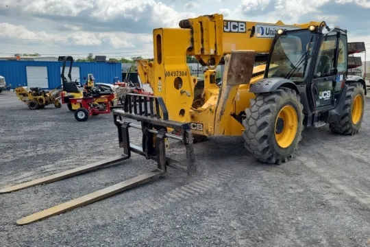

What's great
  • Clean and dry engine compartment, no active leaks
  • Engine starts up with no unusual noises or smoke issues
  • Transmission components are in good condition; no unusual noises or vibrations during operation
  • Chassis and frame are in good condition; level stance
  • Hydraulic lines and fittings are clean and in good condition; no unusual noises during operation
  • Hydraulic cylinders are in good condition; no pitting or discoloration, no oil leaks
  • Great condition of forks, backrest and lifting hook
  • No visible damage to body panels; good paint condition and panel fitment
  • Good cabin appearance; solid floors, panels, and ceiling
  • Operator displays and controls are functioning
What needs work
  • Tires have 30% tread remaining; large area of rubber thread missing from rear right tire
  • Fuel tank possibly cracked, signs of a possible leak
  • Front right side mud guard is damaged, other mud guards are cracked
