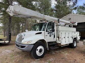

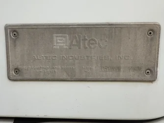

Recently, my boss decided that we needed to buy a bucket truck, the theory being that we will use it to help us with our rental properties and our low voltage installation business. The truck we picked up is a 2003 International 4400 with an Altec body and (I think) Allison automatic. I'm not sure the exact model of body, as I have not been able to find any data plates with a model number on them. The truck was previously owned by Kea Energy and came to us with a Oklahoma title.

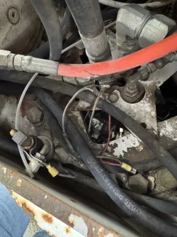

Here's what I've done. I did replace the hydraulic filter today and I topped off the hydraulic tank to the full line on the dipstick with everything stowed and the truck off. This did seem to improve my outrigger responsiveness and speed, as well as improve the speed of the jig moving. I did observe what looks like a small air line snapped off of some type of sensor or trigger at the base of the boom, but I believe this is the switch for what I think is a electric backup pump at the base of the boom. When the truck is running, there's no air coming from either the line or the solenoid. There's also an unknown red 12-24ga wire detached here with a spade connector on it.
