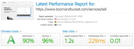

Achieve at least a C rating on the find equipment page in GTMetrix on desktop and mobile.
Mobile:
undefined
Desktop:
Achieve at least an A rating on static landing pages and blog pages on the desktop.
