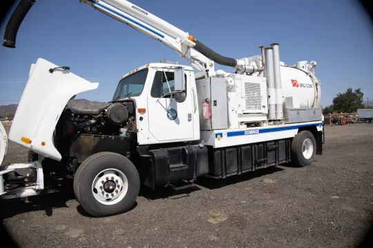

Inspection Summary
inspector
Inspected by Boom & Bucket
  • 1200+ inspections
  • 50+ years experience
  • 20+ certifications
What's great
  • Clean, good appearance, and level stance
  • No weld repairs and no patches were observed
  • Chassis and frame appear straight and in good condition
  • Fluids appear normal and without contamination
  • No engine error codes
  • Easy start, no unusual noises
  • Smooth idle
  • No oil blow-by at operating temps
  • Tires have 75% remaining
  • Strong vacuum function
  • Strong hydraulic function
What needs work
  • Light cosmetic rust
  • Respray on engine and hoses
  • Main Hydraulic Boom pistons have some pitting and discoloration
