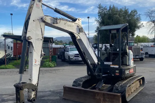

What's great
  • Engine is well maintained, sounds healthy, and runs well under load; no active leaks seen
  • Clean and dry engine compartment; clean oil appearance, no visual signs of cross contamination
  • Drivetrain components appear to be in good condition apart from noted discrpancies
  • Chassis and boom are in good condition, no excess play observed in implements
  • Rubber track belts have more than 70% tread remaining
  • Clean hydraulics; no unusual noises heard during operation
  • Normal wear to blade and blade edge
  • Good lift, angle, and tilt function
  • Good cab appearance with solid floors, panels, and ceiling; good seat condition
  • Operator displays, switches, and joysticks are installed and functional
What needs work
  • Excessive engine smoke at initial startup; no smoke observed after the engine was shut off and restarted
  • Engine is running at higher than normal idle (currently running @1700 rpm)
  • Machine starts with hydraulic lock out engaged (lever at left arm rest)
