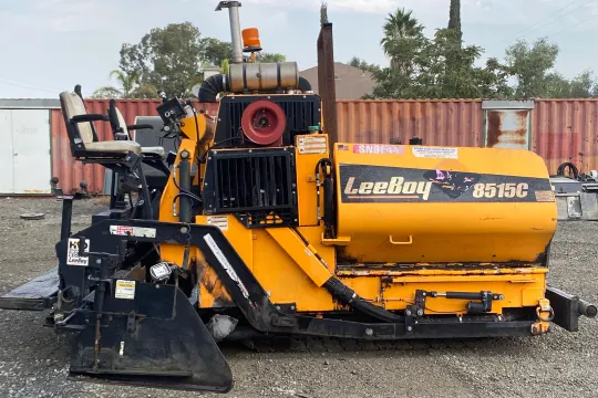

Inspection Summary
inspector
Inspected by Boom & Bucket
  • 1200+ inspections
  • 50+ years experience
  • 20+ certifications
What's great
  • Dry engine appearance; no active leaks seen
  • Good forward and reverse function; no unusual transmission noises heard
  • Good appearance of roller frames, track belt, and track rollers
  • Good appearance and function of screed
  • Good appearance of hopper, conveyor, and auger
  • Clean hydraulics; no oil leaks seen, no unusual noises heard during operation
  • Good appearance of body panels; no visible damage
  • Control station is in good condition; all controls and switches are installed and functional
What needs work
  • Two cracks seen on front hopper bumper frame
  • Right side of diesel fuel hose spray assembly is leaking
  • Slight engine misfire at idle when cold, once warm the engine sounds healthy at all RPMs
